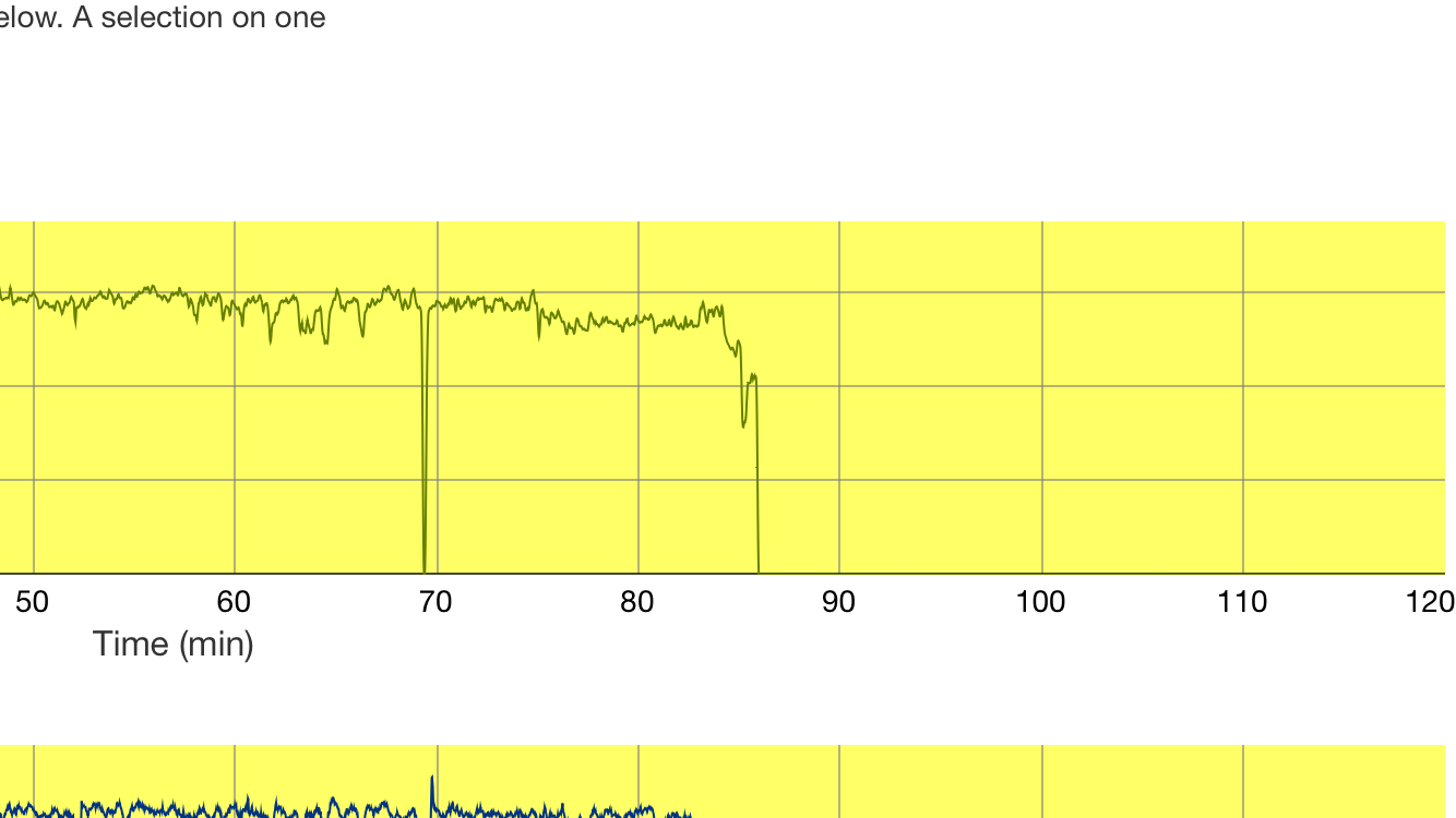

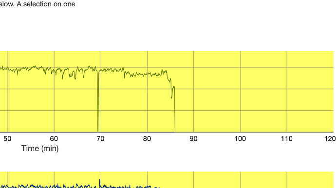

Hello, I did a trainer ride this morning and forgot to stop my garmin until 30 min after I was done. I trimmed it on garmin connect and deleted the activity from Xert and then resynced in hopes that the updated ride would be uploaded but it’s still the original. Why? In garmin connnect it shows the trimmed ride so why does Xert still pull up the file that doesn’t technically exist anymore.
What does the uploaded FIT file look like when you view it with FitFileTools.com?
Has an extra 30 minutes of nothing.
I have a feeling that Garmin only trims the ride on their own platform - perhaps they make a modified version of the file for their own site.
I suspect they don’t make any changes to the original .fit file, just like with elevation corrections.
Note you can change the Activity Time Method setting to Total, Moving or Pedaling under Profile Settings/General. Setting it to Moving or Pedaling should not count that time at the end of the ride.
