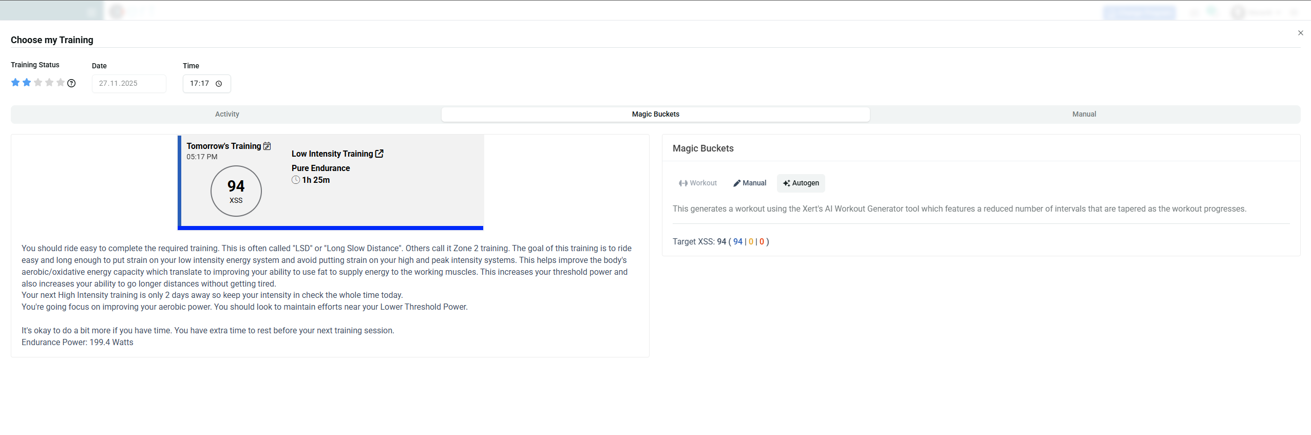

Hi,
I switched over to a “goal” program and let the forecast AI run.
Now I want XERT to generate a workot, but it won’t let me:
There is no button to generate. Any advise? Is this feature broken?
Thanks in advance for any help!

Magic Buckets generator tab only works for HIT workouts with high/peak strain.
If Pure Endurance LIT is recommended there are no intervals to generate.
However, you can still use the Autogen function (select Save button in bottom right). That will create a rather bland sub-LTP workout. ![]()
There are plenty of easy endurance level workouts to choose from if that’s what you are looking for. For Pure Endurance you could alternately ride at your Z2 pace without trainer control until you’ve filled the Low bucket for the day.

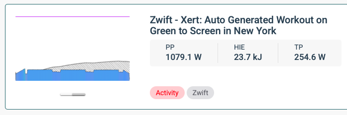

Thanks for your reply.
First of all, apologies - I simply did not wait long enough after pressing save. Stupid me! ![]()
So, problem solved I guess. Just wanted start messing around with Forecast AI and what sessions it genrates. I actually don’t mind riding zone2 / zone3 in ERG Mode. I am a bit bored by COCO at the moment ^^

I was in a bit of the opposite mode recently… I didn’t want to do endurance workouts so I would free ride with pace bots. But like you said, I didn’t necessarily want the monotony of that so I literally autogenerated a workout to ride this morning in ERG mode ![]()
