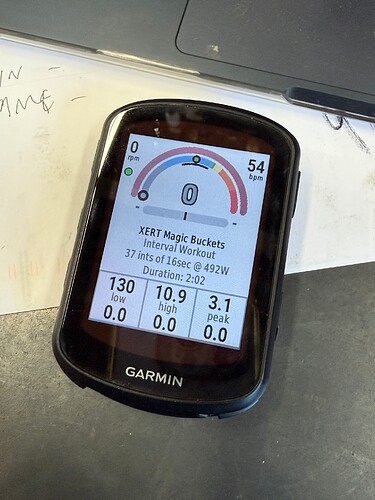

Been using magic buckets for months now and when it’s not an endurance ride I get the exact same interval workout suggestion every single time, which is X number of intervals of 16sec @ 500w +/-. My current settings are Program : continuous & Type : Puncheur, which has a focus duration of 4 min. with 11-12 hours a week to train. Not once have I ever gotten a 3-4 min interval suggestion.
I know I can alter the duration of these intervals on the fly and often do. I rarely do the 16 second interval, usually 20sec on up to 2 min. Am I wrong in thinking that if I set my type to Puncheur xert will give me workouts that will help me improve my 4 min power? Is magic buckets a completely independent system? Magic bucket workouts are always very different than if I use the Ai to generate a workout.

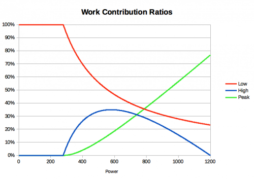

thats what it is for. Took me also some time to understand: XMB always calculates the highest(!) power with given high and peak ratio to fill the buckets as time efficient as possible.
As you see in the article below, at about 300W TP this athletes proposed interval power will always be 360-700W depending on his focus duration. XMB does not care on HIT other than pushing XHSS and XPSS.

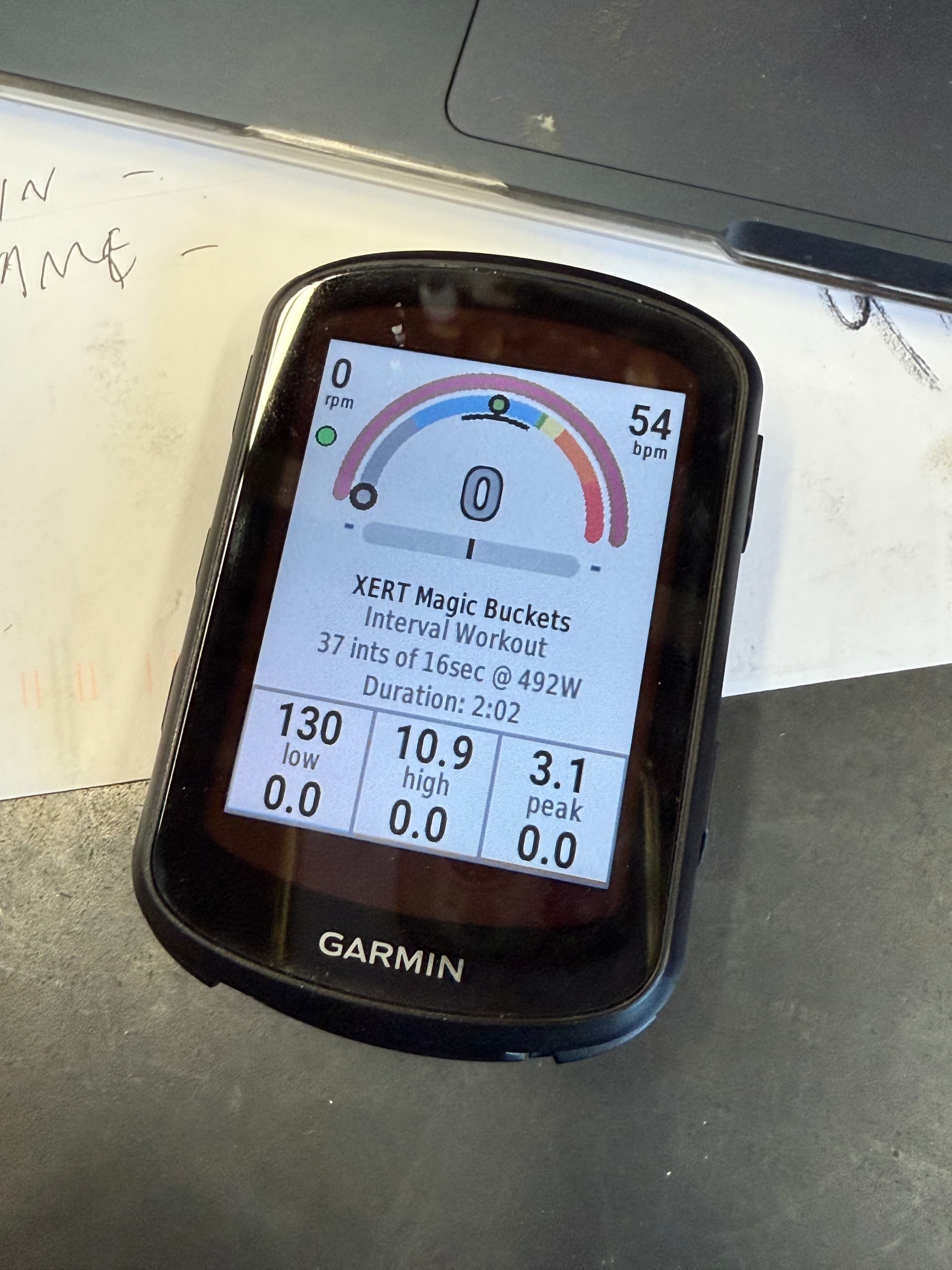

I came to aske some questions about magic buckets and I think this answers my questions but I wanted to make sure I am getting it. I just started using magic buckets this week. For every day I am doing the magic bucket auto generation feature on the planner. I go in and look at what the workout is supposed to be. However that is never the workout that my garmin tells me to do. It does always have the correct XSS numbers, but the intervals are always higher power efforts than what was described in the workout in the planner. What I am reading here is that once the Garmin has it, the algorithm is going to give me the more efficient way possible to fill the buckets? If I want to do the prescribed workout from the planner I just have to remember what that was and do it on my own?
Yeah, I think you need to use the workout player which is a completely different window on your garmin, it can’t be added as a page unfortunately, if you want to follow the workout. Though when you first open the magic bucket window on your garmin it gives you a quick rundown of the workout. Usually ‘34’ intervals (that translates to 17 intervals hard and 17 in-between those hard ones) at around 170% of ftp. I really wish you could pull the outline back up after you’ve started but you can’t. Also, the workout you create online with magic buckets does not carry over to the magic bucket page on your garmin UNLESS you use the xert workout player (I think so someone can verify that). It takes a bit to learn the magic bucket page but once you do it’s possible to follow the workout using the timer, though it never tells you explicitly when to stop the interval, you just stop when you stop and the remaining XSS adjusts. It just has a timer that keeps rolling until you drop the watts. Though there is the ‘intesity’ bar that I think is calibrated to the current challenge level and once it reaches the far right you can stop the interval. I know, it’s convoluted.
