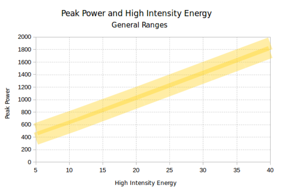

How closely do your PP and HIE align with the median band shown in this normalized scatter plot chart?

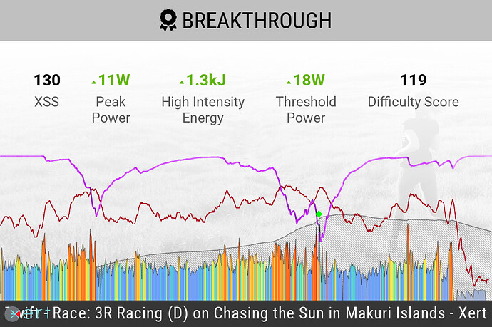

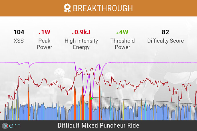

I wasn’t watching my MPA during this attack at all - I was just trying to hold on for dear life and push as many watts as I could to hold off the pack at the end of a race. After many years of Xert, it’s still fascinating to me how well MPA tracks with how close I was to my limit for the last ~2 minutes of the race during a 1200m attack to the finish. I figured that was my best chance, rather than trying to outspent some 80kg powerful sprinters:

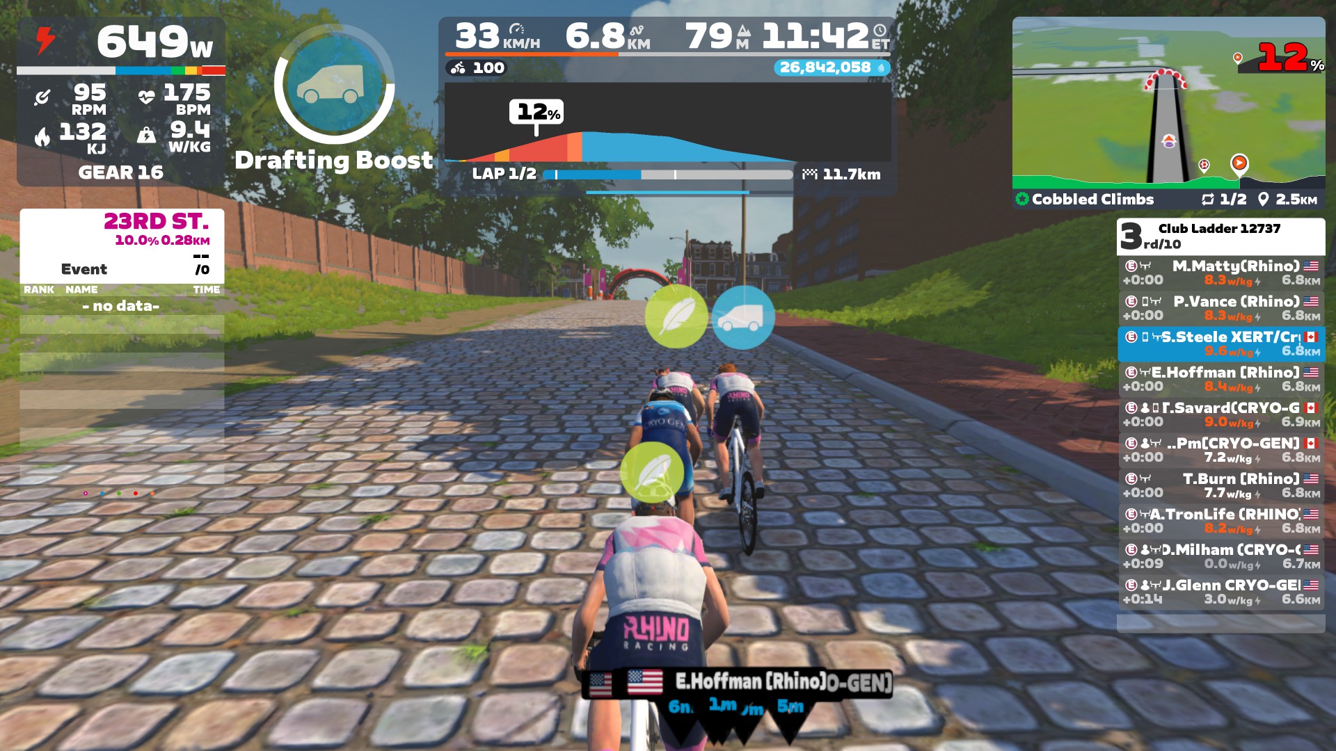

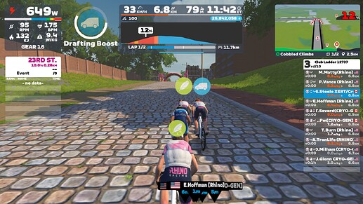

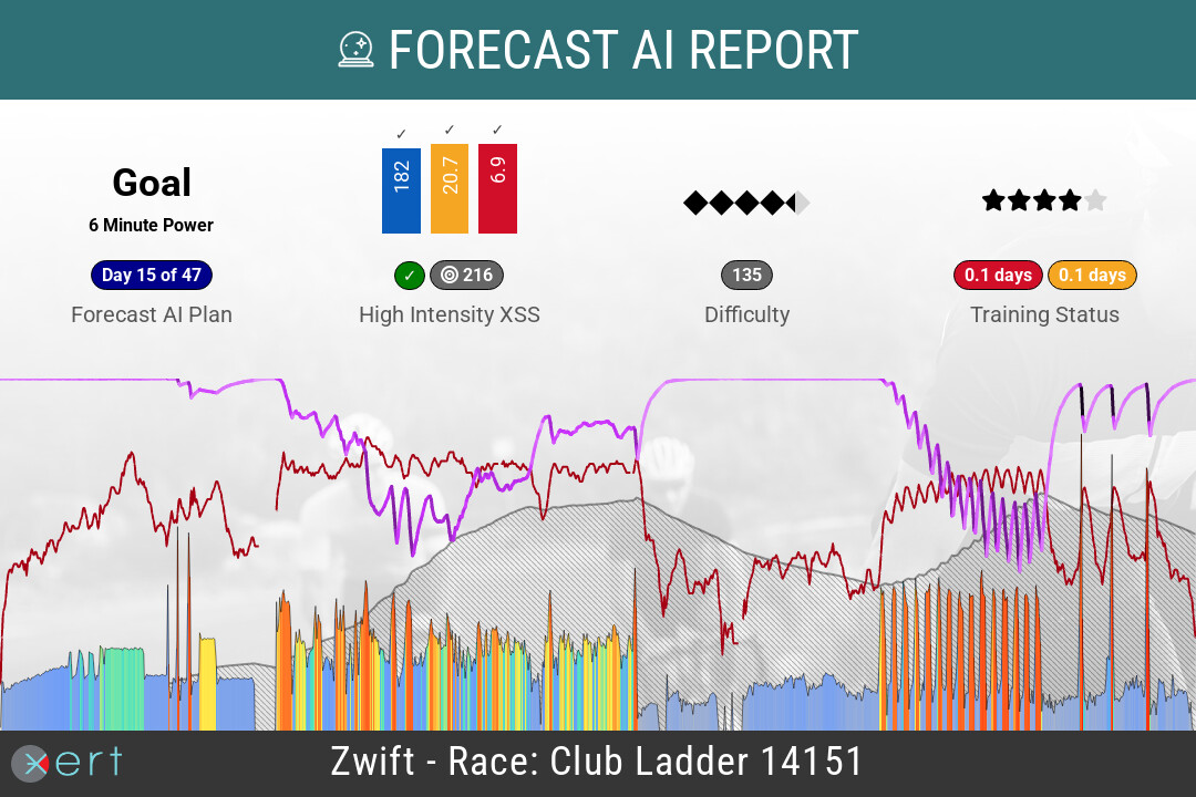

My team had a punchy Zwift Ladder race featuring 2 laps of the “Cobbled Climbs” course in Richmond, which made for an intense ladder race with lots of attacks & counterattacks.
As expected, it was a calm start until the base of the first climb - then it was full gas!

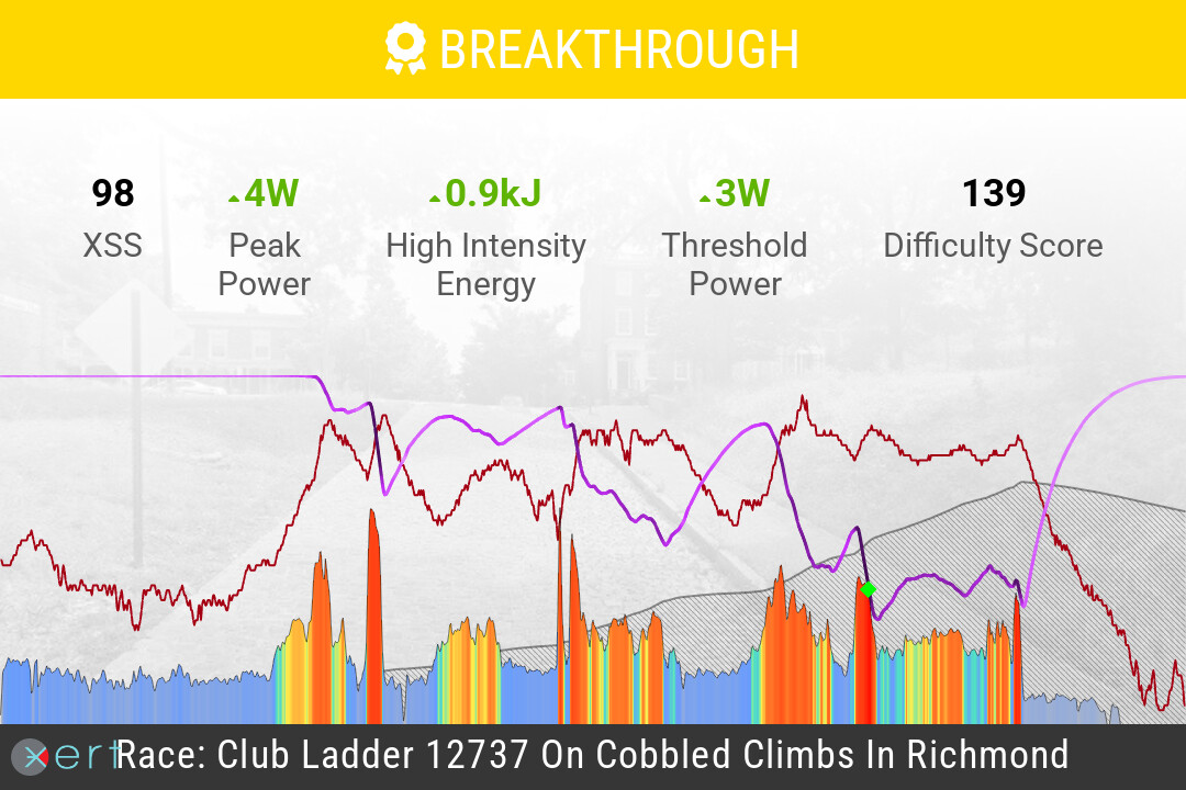

We were pretty evenly matched after the first lap. A teammate and I did try to breakaway on the second lap, but we were reeled back in after 5 min or so. We attacked again over the two climbs & got a small gap, but they were relentless and caught me before the final climb to the finish. The team was able to secure 1st & 2nd, and I was able to out-“sprint” one of them at the line for 4th place. Sprinting when your MPA is only 500 W is so painful!
I wasn’t happy to be caught by the group behind me before the finish, but at least my consolation is that I achieved my first GOLD breakthrough in quite some time! :smiley:

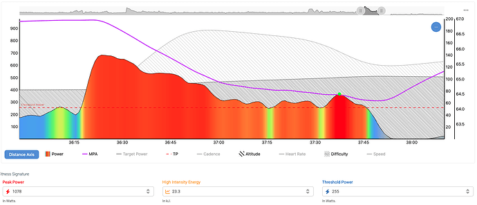

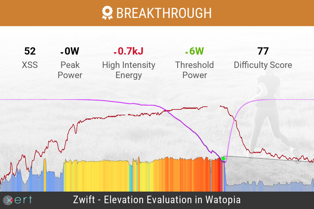

Just after I had a breakthrough on monday last week climbing Alpe du Zwift (228w for 59 minutes), I had another breakthrough on Elevation Evaluation (grade KOM) riding 255w for 15m. Started easy and then last 4/5m you can see I accelerated to 270w contineously. Exceeding MPA.
I had calibrated MPA 2 weeks before by riding the fitness test (max sprints + 4 treshold efforts) when I returned to Xert. Now my TP sits at 240w and MPA at 755. Almost back to my best level of last september (I lost a lot of fitness in december month by doing nothing).

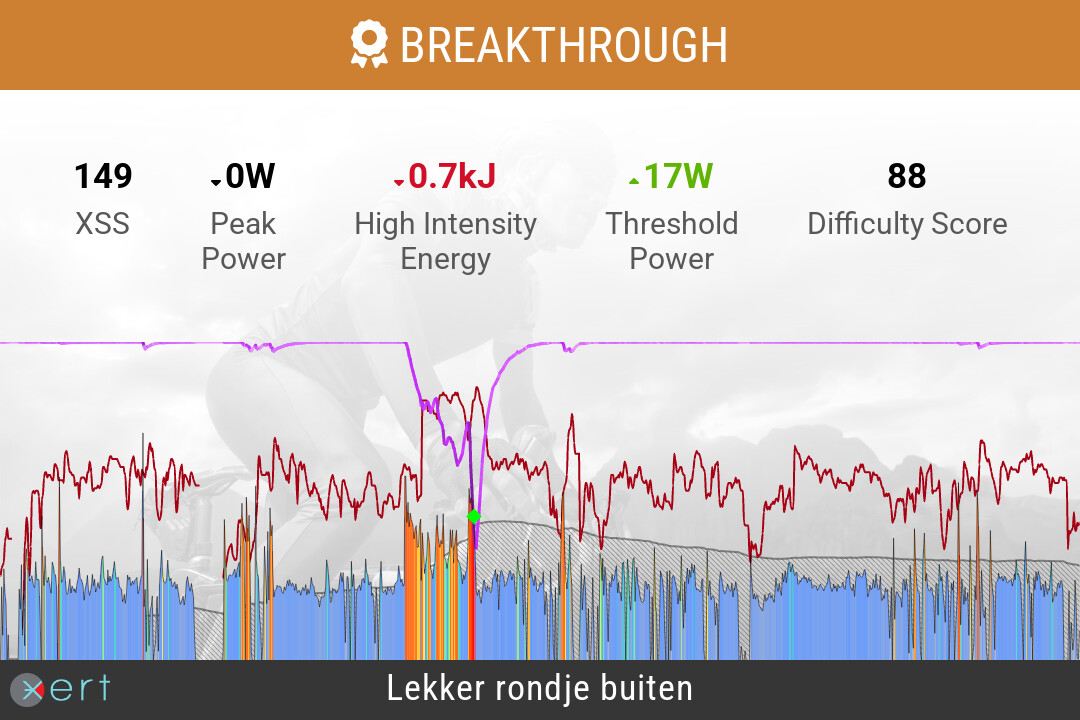

First outside ride of the year (thats not on my commuter)..
And another one.
I know indoor and outside power differ for me. But what the fuck. I had magic buckets and completed the intervals on my favorite segment… which lead to a spectacular breakthrough.
So in the space of 1 month I went from 225 TP due to lack of training to almost my all time high, its now 259. My peak was 260 last september.

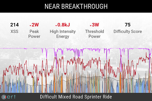

Keep having breakthroughs when i go outside. HIE has been going down everytime though. Not that I’m too bothered by that. Its just a slightly undulating part I use to fill the intensity buckets and then the rest of the ride is filling the endurance magic bucket.

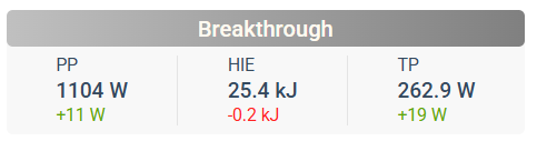

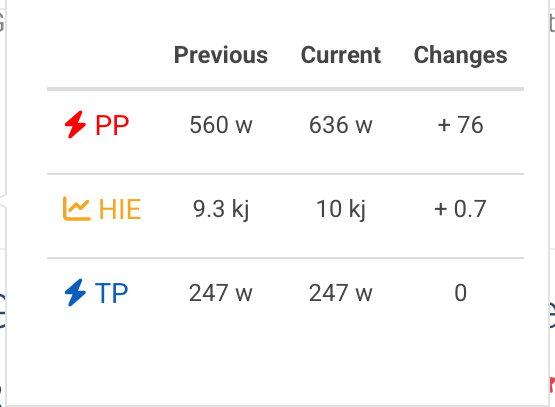

My First Fitness Test on Xert to dial in my signature :grin:

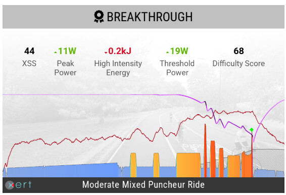

Yesterday was a warm day in the 70s with a slight wind. Spring has arrived!
I went outdoors for a 3+ hour meander and got carried away charging up the crest of hills.
The result was this –

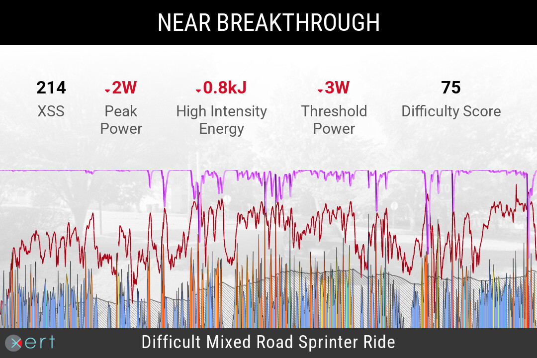

Hey, this happens sometimes! I’m not worried about it. :wink:
I treat Near BTs as confirmation my signature is dialed in.
What freaks out many newbies is when they see any number decline for the first time, especially during a training block. But that makes perfect sense. Consider it a rite of passage.
Your signature values are not static numbers and should float day to day.
I blame old-school periodic FTP test indoctrination. It was a number you hit on that particular day – with that particular test protocol – then relied on it as an anchor point for the next 4-6 weeks. However, all along your FTP was fluctuating and likely increasing during a progression. That means those 82 and 94% SS block intervals you blindly accepted as sacrosanct were only 82 and 94 for a few days after your last test. :man_shrugging:
The other factor is TP/FTP isn’t a value measured to a decimal point. Sure, a math model calculates in that fashion, but no one should kid themselves into thinking their TP is 188, or 251, or 302. It’s +/- 2% or round down to the nearest 5 pt increment. :smiley:
All you really care about is whether your TP is trending up, down, or plateaued (stagnant) over time. And when it does plateau that doesn’t mean you can’t continue to improve your fitness.

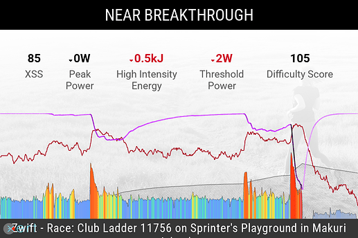

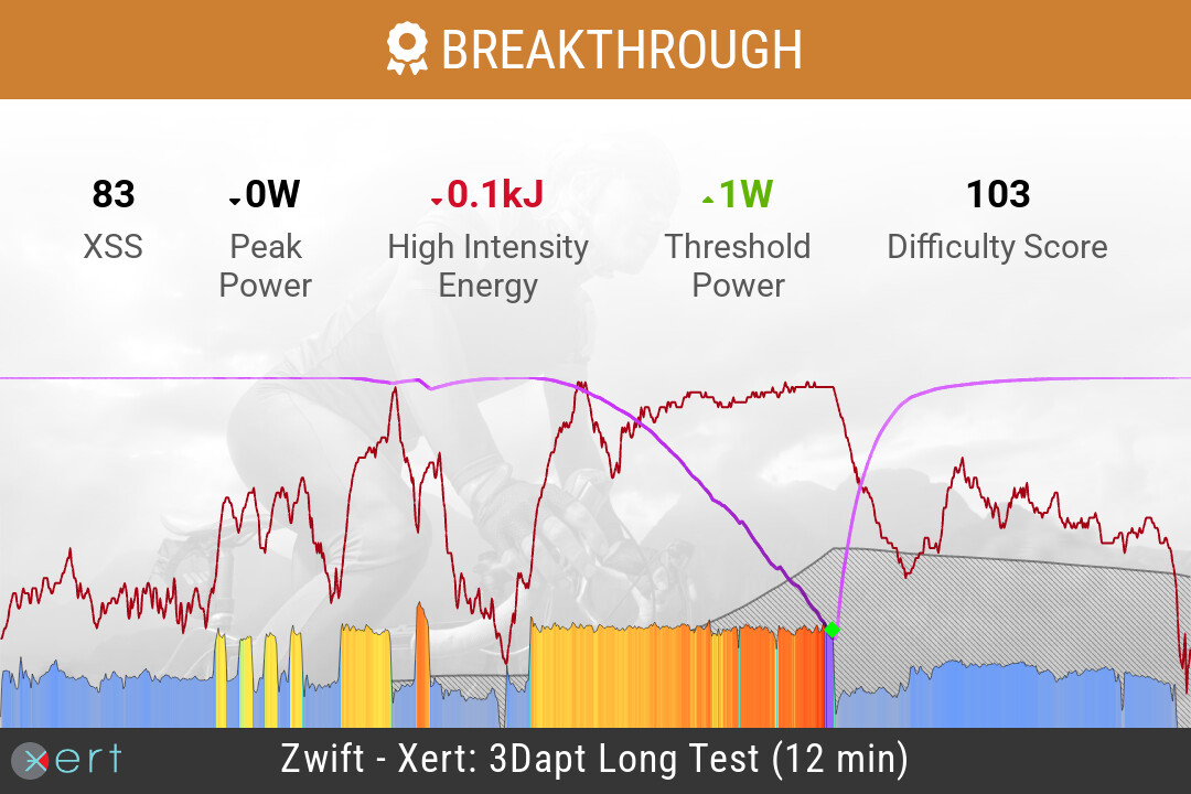

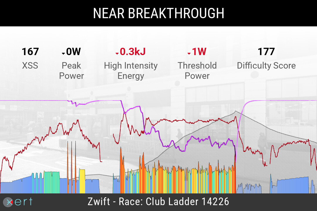

I had a tough run of 3 back to back to back hard days:
Sun: 3Dapt Research Study 12 min power test (Breakthrough)

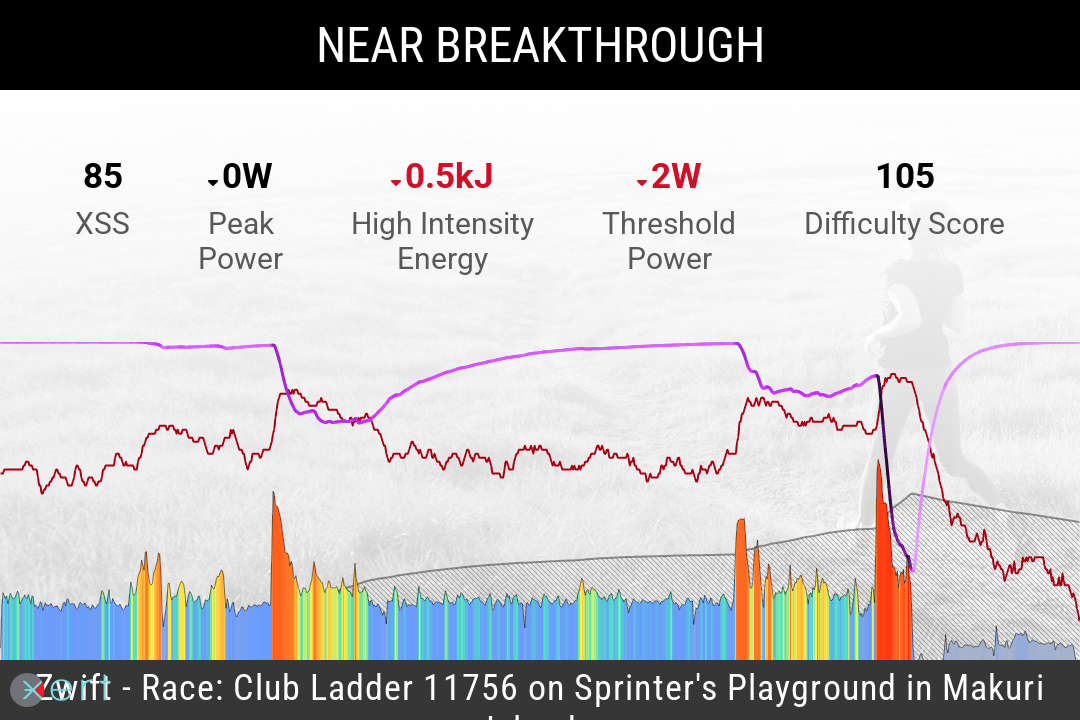

Mon: Zwift Ladder Race (Near-Breakthrough)
Tues: Another Ladder Race (another Near-Breakthrough)
I’m chalking up the two Near-Breakthroughs to having residual fatigue in my legs from the previous couple days of hard riding. I did flag the Near-Breakthrough on Tuesday as I felt it was a max effort on that day, but I know that I’m capable of more when I’m fresh, so I wanted the numbers to reflect that.
