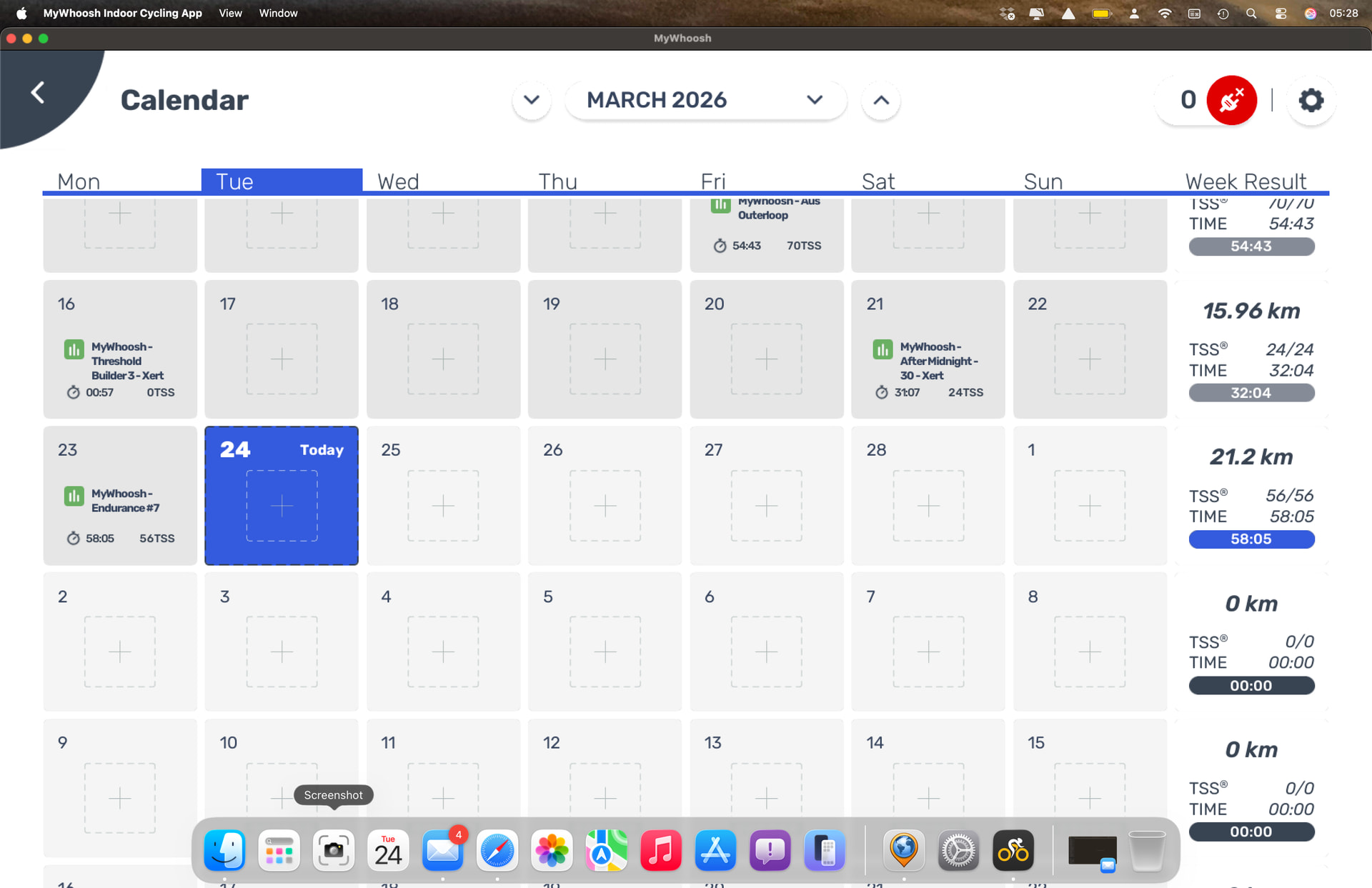

How can i connect the plan i have here on Xert to MyWhoosh? I already connect it on MyWhossh Profile, but it does not appear on My Whoosh Calendar..
Can Anyone help?

I found this worked the first time I used MyWhoosh, but not since. my work around is to open the workout in XERT, download a two file and then use the MyWhoosh Workout Editor web page to import the workouts into the My workout area.
But I’ll still keep trying the above method as you can only import ten of your own workouts
I’ve just tried it again this morning and no workout shows
