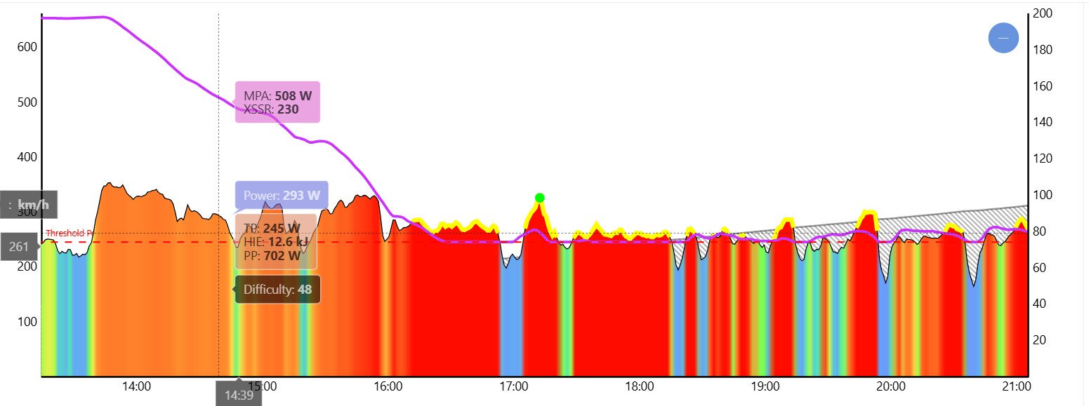

Most of the breakthoughs which push my TP higher than I estimate it should be are 5-10 minute efforts, eg. yesterday:
From that screenshot it looks like PP is low relative to TP at around 650w - is that your true max? If you are injured, or only sprinting indoors, or you just don’t do max sprints, it’s likely understated so you may want to increase both PP and HIE and lower TP accordingly… best is to do some all out sprints outdoors, when fresh and warmed up, though
Interesting, seems I need to do some reading about how PP affects TP and vice versa. Most of my harder efforts are during zwift racing, or short hills outdoors, so 1-8 minute effort, rare that I do max sprints - I expect my max sprint to be nearer 750w minimum
I just added 100 w to my PP, and it brought my TP down by 2%. Or thereabouts. If I can add more watts through an outdoor Sprint, then your theory may be the answer to my problem.
