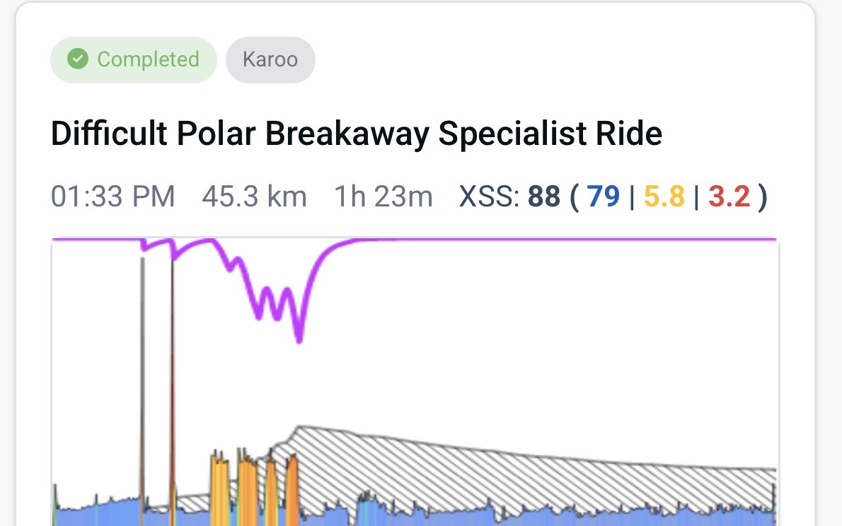

Again discrepancy between magic buckets and Xert Dashboard
I have filled all my buckets today. On the Karoo, 103 XSS easy, 11.5 XSS high and 4 XSS Peak were shown as done. And this is now displayed to me on the Xert Dashboard:
I know that there is a difference, because it is always adjusted in real time, but that is a very big difference to me that cannot be true.

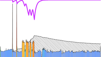

I just noticed something else. I was at challenge level 9 and at least 10-15 seconds at maximum because I wanted to make a breakthrough. But as listed above, my MPA has barely dropped.
I think you misunderstood me or I don’t understand. At the beginning the buckets were exactly as intended, so they were exactly the same on my Karoo as on the Xert Dashboard. I filled them all and was, as already mentioned, 10-15 seconds above Challenge Level 9, which should have given a breakthrough. Only after uploading to Xert there was this giant difference.

I wouldn’t call that “barely dropped”. :wink:
Make the activity public under activity details and post the url.

Here is the workout:
